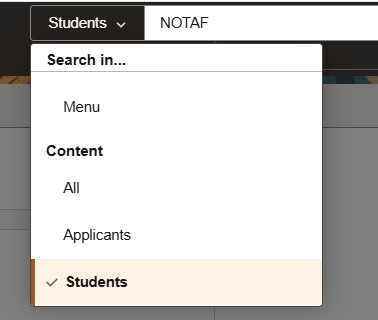

    Depending on what you are doing with the final dataset, you could consider using Opensearch/Insights. We have a few running, all with PSQUERY as the datasource. These run as full datasets overnight, then every half hour during the day using the Incremental method.
    Some of the datasets just feed into the Global Search on the page header. e.g.
    Some feed into Insights (Kibana) reports/dashboards for users to further drill down into data.
    Maybe worth looking at. I think 8.62 has further enhancements as to how Incremental PSQUERYs work. In these cases though, although PSQUERY is running an Incremental load, the results are added to the main dataset. So you would need to set a Status field or something to identify the latest additions.

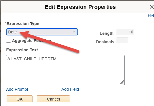

    If I only need the date field, I just use an expression, change the type to "Date" and then put the date/time field in there and then "Use Field".
  • 10.  RE: Incremental Data feed from Campus solution through PS Query
    Posted 05-16-2025 03:31 PM
    Hi Lee,
    I would caution against updating just the expression properties unless you are sure that you will not be using it in your criteria. Only because in my experience, that only changes the output format, and doesn't change the underlying SQL.
    So you might risk running into that field appearing as though it is a date, but still remaining a datetime behind the scenes. This could impact criteria that you set against that expression, especially if you are setting the OPERAND to 'EQUAL TO' some date.
