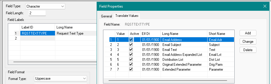

    I am trying to identify the record where Distribution Detail is stored. This is what you get when you are about to start a process, and on the Process Scheduler Request page press the Distribution link. I'm interested in the Email Subject, Message Text, Email Address List and Distribution ID. It looks like it should be a combination of PRCSRQSTDLG and PRCSDEFNDIST_VW, however when I asked for access to PRCSRQSTDLG I was told that it doesn't exist, while
    PRCSRQSTDLGLNG does exist, it doesn't contain any data.
    Also, PRCSDEFNDIST_VW doesn't contain any data.
    Does anyone know how to get to this data?

    Hi Kevin,
    I think it might be PSPRCSRQSTTEXT you want.
    There could be multiple rows for a process instance, including the email address, subject and text.
    Hope this helps!
