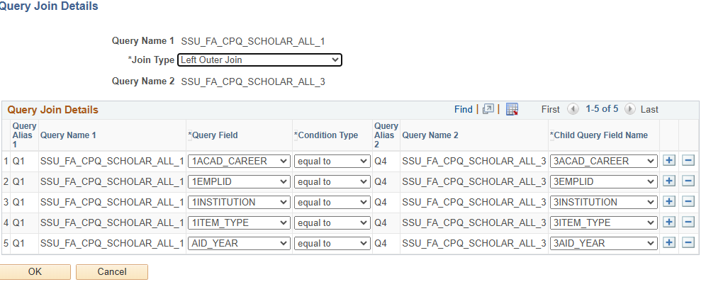

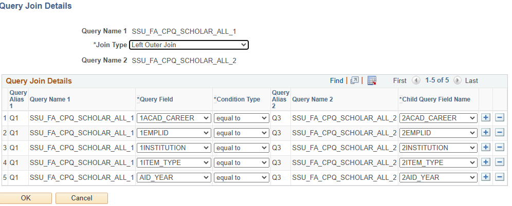

    Thanks to your wonderful webinar, I was able to create a composite query for our scholarship coordinator that has one row for each scholarship awarded with both Fall disbursement and Spring disbursement data in one row...yay!
    One issue I haven't figured out is what to do with scholarships that have more than one disbursement per term. The output of my current composite query is producing 4 rows instead of one...one row for the first Fall disbursement with the first Spring disbursement data, a second row for the first Fall disbursement with the second Spring disbursement data, a third row for the second Fall disbursement with the first Spring disbursement data, and a fourth row for the second Fall disbursement with the second Spring disbursement data.
    Ideally, there would be a column in the output for each of those second disbursements...all on one row.
    Here is the SQL:
    SELECT DISTINCT Q1."1EMPLID",
        Q1."1NAME",
        Q1."1EMAIL_ADDR",
        Q1."1TEM_TYPE",
        Q2."4IT_DESCR",
        Q2."4FUND_CODE",
        Q2."4DEPTID",
        Q3."2STRM",
        Q3."2DISB_ID",
        Q3."2OFF_BAL",
        Q3."2ACC_BAL",
        Q3."2DISB_BAL",
        Q3."2ACAD__PLAN",
        Q3."2ACAD_CAREER",
        Q4."3STRM",
        Q4."3DISB_ID",
        Q4."3OFF_BAL",
        Q4."3ACC_BAL",
        Q4."3DISB_BAL",
        Q4."3ACAD_PLAN",
        Q4."3ACAD_CAREER"
    FROM
      (SELECT DISTINCT A.EMPLID AS "1EMPLID",
        B.NAME AS "1NAME",
        C.EMAIL_ADDR AS "1EMAIL_ADDR",
        A.ITEM_TYPE AS "1TEM_TYPE",
        A.ACAD_CAREER AS "1ACAD_CAREER",
        A.INSTITUTION AS "1INSTITUTION",
        A.AID_YEAR AS "1AID_YEAR"
      FROM PS_STDNT_AWARDS A,
        (PS_SCC_PERDATA_QVW B LEFT OUTER
    JOIN
         PS_SCC_EMAIL_QVW C
    ON
         B.EMPLID = C.EMPLID AND C.E_ADDR_TYPE = 'OCMP' )
      WHERE ( A.INSTITUTION = 'SOCMP'
         AND A.AID_YEAR = '2026'
         AND ( A.ITEM_TYPE BETWEEN '800000000000' AND '800000099999'
         OR A.ITEM_TYPE IN ('840000004500','840000004501','840000005300'))
         AND A.EMPLID = B.EMPLID
         AND A.OFFER_AMOUNT > 0) ) Q1
    JOIN
        ( SELECT B.DESCR AS "4IT_DESCR",
        E.FUND_CODE AS "4FUND_CODE",
        E.DEPTID AS "4DEPTID",
        B.SETID AS "4SETID",
        B.ITEM_TYPE AS "4ITEM_TYPE",
        B.EFFDT AS "4EFFDT",
        B.EFF_STATUS AS "4EFF_STATUS",
        C.STRM AS "4STRM",
        C.EFFDT AS "4GL_EFFDT",
        C.EFF_STATUS AS "4GL_EFF_STATUS"
      FROM PS_ITEM_TYPE_1_TBL A,
        PS_ITEM_TYPE_TBL B,
        PS_GL_INT_DT_TBL C,
        PS_GL_INTERFACE E
      WHERE ( B.SETID = A.SETID
        AND B.ITEM_TYPE = A.ITEM_TYPE
        AND C.SETID = A.SETID
        AND C.ITEM_TYPE = A.ITEM_TYPE
        AND ( B.EFFDT =
            (SELECT MAX(B_ED.EFFDT) FROM PS_ITEM_TYPE_TBL B_ED
            WHERE B.SETID = B_ED.SETID
              AND B.ITEM_TYPE = B_ED.ITEM_TYPE
              AND B_ED.EFFDT <= SYSDATE)
         AND A.SETID = 'SOCMP'
         AND B.EFF_STATUS = 'A'
         AND C.EFFDT =
            (SELECT MAX(C_ED.EFFDT) FROM PS_GL_INT_DT_TBL C_ED
            WHERE C.SETID = C_ED.SETID
              AND C.ITEM_TYPE = C_ED.ITEM_TYPE
              AND C.STRM = C_ED.STRM
              AND C.SESSION_CODE = C_ED.SESSION_CODE
              AND C_ED.EFFDT <= SYSDATE)
         AND C.STRM = (SELECT MAX( D.STRM)
      FROM PS_GL_INT_DT_TBL D
      WHERE D.EFFDT =
            (SELECT MAX(D_ED.EFFDT) FROM PS_GL_INT_DT_TBL D_ED
            WHERE D.SETID = D_ED.SETID
              AND D.ITEM_TYPE = D_ED.ITEM_TYPE
              AND D.STRM = D_ED.STRM
              AND D.SESSION_CODE = D_ED.SESSION_CODE
              AND D_ED.EFFDT <= SYSDATE)
         AND D.SETID = C.SETID
         AND D.ITEM_TYPE = C.ITEM_TYPE)
         AND A.SETID = E.SETID
         AND A.ITEM_TYPE = E.ITEM_TYPE
         AND E.EFFDT =
            (SELECT MAX(E_ED.EFFDT) FROM PS_GL_INTERFACE E_ED
            WHERE E.SETID = E_ED.SETID
              AND E.ITEM_TYPE = E_ED.ITEM_TYPE
              AND E.STRM = E_ED.STRM
              AND E.SESSION_CODE = E_ED.SESSION_CODE
              AND E_ED.EFFDT <= SYSDATE)
         AND E.DB_CR_IND = 'D'
         AND E.STRM = C.STRM )) ) Q2
    ON
         Q1."1TEM_TYPE" = Q2."4ITEM_TYPE" LEFT OUTER
    JOIN
        ( SELECT DISTINCT A.STRM AS "2STRM",
        A.ITEM_TYPE AS "2ITEM_TYPE",
        A.DISBURSEMENT_ID AS "2DISB_ID",
        A.OFFER_BALANCE AS "2OFF_BAL",
        A.ACCEPT_BALANCE AS "2ACC_BAL",
        A.DISBURSED_BALANCE AS "2DISB_BAL",
        B.DESCR AS "2ACAD__PLAN",
        A.EMPLID AS "2EMPLID",
        A.ACAD_CAREER AS "2ACAD_CAREER",
        A.AID_YEAR AS "2AID_YEAR",
        A.INSTITUTION AS "2INSTITUTION"
      FROM ((PS_STDNT_AWRD_DISB A LEFT OUTER
    JOIN
         PS_STDNT_FA_TERM C
    ON
         A.EMPLID = C.EMPLID AND A.INSTITUTION = C.INSTITUTION AND A.AID_YEAR = C.AID_YEAR AND A.ACAD_CAREER = C.ACAD_CAREER AND C.STRM = A.STRM AND C.EFFDT =
            (SELECT MAX(C_ED.EFFDT) FROM PS_STDNT_FA_TERM C_ED
            WHERE C.EMPLID = C_ED.EMPLID
              AND C.INSTITUTION = C_ED.INSTITUTION
        AND C.EFFSEQ =
            (SELECT MAX(C_ES.EFFSEQ) FROM PS_STDNT_FA_TERM C_ES
            WHERE C.EMPLID = C_ES.EMPLID
              AND C.INSTITUTION = C_ES.INSTITUTION
              AND C.STRM = C_ES.STRM
              AND C.EFFDT = C_ES.EFFDT) ) LEFT OUTER
    JOIN
         PS_ACAD_PLAN_TB_VW B
    ON
         C.INSTITUTION = B.INSTITUTION AND B.ACAD_PLAN = C.ACAD_PLAN )
         AND A.STRM = '2257'
         AND A.OFFER_BALANCE > 0) ) Q3
    ON
         Q1."1EMPLID" = Q3."2EMPLID" AND  Q1."1ACAD_CAREER" = Q3."2ACAD_CAREER" AND  Q1."1INSTITUTION" = Q3."2INSTITUTION" AND  Q1."1AID_YEAR" = Q3."2AID_YEAR" AND  Q1."1TEM_TYPE" = Q3."2ITEM_TYPE" LEFT OUTER
    JOIN
        ( SELECT DISTINCT A.STRM AS "3STRM",
        A.ITEM_TYPE AS "3ITEM_TYPE",
        A.DISBURSEMENT_ID AS "3DISB_ID",
        A.OFFER_BALANCE AS "3OFF_BAL",
        A.ACCEPT_BALANCE AS "3ACC_BAL",
        A.DISBURSED_BALANCE AS "3DISB_BAL",
        B.DESCR AS "3ACAD_PLAN",
        A.EMPLID AS "3EMPLID",
        A.ACAD_CAREER AS "3ACAD_CAREER",
        A.AID_YEAR AS "3AID_YEAR",
        A.INSTITUTION AS "3INSTITUTION"
    JOIN
         PS_STDNT_FA_TERM C
    ON
        AND C.EFFSEQ =
    JOIN
    ON
         AND A.STRM = '2263'
         AND A.OFFER_BALANCE > 0) ) Q4
    ON
         Q1."1EMPLID" = Q4."3EMPLID" AND  Q1."1ACAD_CAREER" = Q4."3ACAD_CAREER" AND  Q1."1INSTITUTION" = Q4."3INSTITUTION" AND  Q1."1AID_YEAR" = Q4."3AID_YEAR" AND  Q1."1TEM_TYPE" = Q4."3ITEM_TYPE"
    ORDER BY Q1."1NAME" ASC

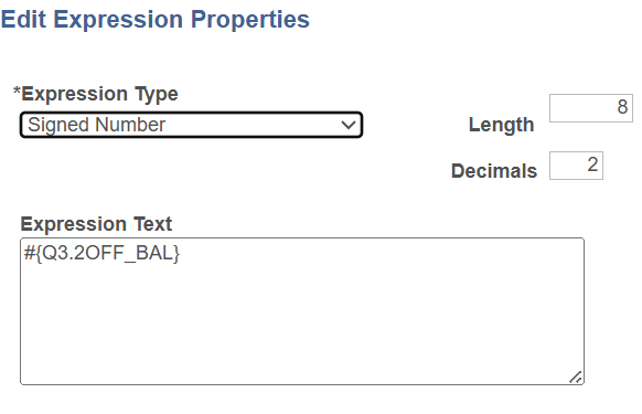

    It would be fine to sum the disbursements for each term. So far, I have tried two methods...
    Method #1: I tried creating an expression for each of the term amount fields (Offered, Accepted, Disbursed) and using those in the Fields instead of the term amount fields, which resulted in just one row for the student's scholarship (yay!) but the amounts are double what they should be.
    The expression looks like this (and I had to choose Aggregate Sum in the field properties):
    I didn't save the SQL from Method 1, but I could recreate that and include it in another post if that would help.
    Method #2: Instead of using the expressions in the Fields, I tried choosing Aggregate Sum in the field properties for each of the term amount fields, and again I got one row for the student's scholarship but the term amounts were doubled.
    (I also tried taking the fields from FA Term for Academic Plan and Career out of the Fields, but the term amounts still doubled.)
    Here is the SQL for Method 2:

    Susan,
    I was about to message you today that the best bet is to take care of the multiplying values in the base queries rather than at the Composite Query level.  Seems you beat me to it! Kudos.  When joining to other tables that may have multiple rows per student, it can multiply those sums.
    I too have an expression that @Jeffrie Brooks came up with to handle that.  I almost use it be default now.  I am attaching a small write up I have of it.

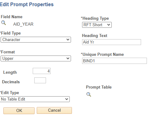

    Posted 01-08-2026 06:43 PM
    Regarding using prompts for AID_YEAR and STRM in a Composite Query, is it necessary to delete the AID_YEAR and STRM criteria from the base queries?
    ChatGPT tells me:
    CQM replaces the hard-coded value at runtime" if
    The replacement happens when ALL of these match:
      1. The base query has a hard-coded constant
      2. The field name matches the composite prompt field
      3. The data type matches
      4. The composite prompt is defined for that field
    However, I'm only getting the prompts recognized in the Composite Query when I delete AID_YEAR and STRM criteria from the base queries.
    Susan Gutierrez
    FA and SF Functional Analyst
    Sonoma State University
  • 17.  RE: Follow Up to "Using Composite Query - Demonstration and Discussion" (07/30/2025)
    Posted 01-08-2026 07:20 PM
    Hello Susan,
    The base queries cannot have prompts in them when used in Composite Query. You must add the prompts within Composite Query itself.  This is unlike Connected Query where you are allowed prompts in the base queries.
  • 18.  RE: Follow Up to "Using Composite Query - Demonstration and Discussion" (07/30/2025)
    Posted 01-08-2026 07:29 PM
    Dan - You beat me to it!  You're so fast....but yes, I agree.  You have to remove the prompts from your data-source queries, and add them at the Composite Query level.

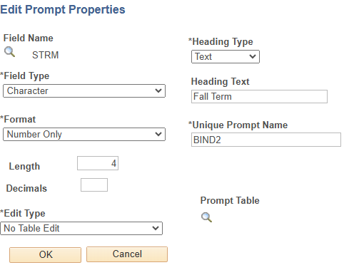

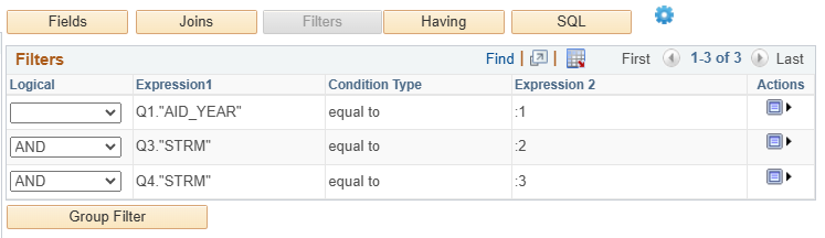

  • 21.  RE: Follow Up to "Using Composite Query - Demonstration and Discussion" (07/30/2025)
    Posted 01-09-2026 01:57 PM
    Removing AID_YEAR and STRM criteria in my base queries and adding prompts for those values in the Composite Query works, but I am having a problem with outer joins when I use prompts.
    My parent base query has award data from STDNT_AWARDS, which gives me the award year amounts for each item type. Then I have two child base queries with award data from STDNT_AWRD_DISB, one for Fall and the other for Spring.
    I am trying to use an outer join with the for those children to the parent base query, to show Fall values for the item type when the student has a Fall award, and Spring values when the student has a Spring award.
    When I hard-code the AID_YEAR and STRM in the base queries, the outer joins work in the Composite Query and I get the award year values plus Fall and/or Spring values (if they exist) all in one row for the item type. However, when I take the hard-coded values out of the base queries and use prompts in the Composite Query, it's filtering out the rows that don't have both Fall and Spring data.
    The Joins look like this:
    The prompts look like this:
    The Filters look like this:
    Does that give you enough to help me figure out why the prompts are causing me to lose the rows with only Fall award data or only Spring award data?

  • 22.  RE: Follow Up to "Using Composite Query - Demonstration and Discussion" (07/30/2025)
    Posted 01-13-2026 08:06 AM
    Good Morning Susan -
    • In looking at the Joins, one thing I would do is review the Inner Join you have - perhaps that is the issue?
    • I would think that the issue is not caused by the prompts, but you could always try and hard code that criteria to test that theory.
    • I was going to ask what happens if you hard coded the Term values in the base queries, but in re-reading, it appears that was working.
    I am far from an expert on Composite Query, but it sounds to me like you are attacking this in the way I would.  You might have to settle for some combination of hard-coding and prompts, even though that is not optimal.   I will keep thinking about this, and I am interested in any further developments you discover.

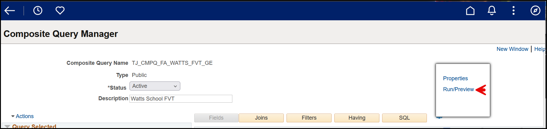

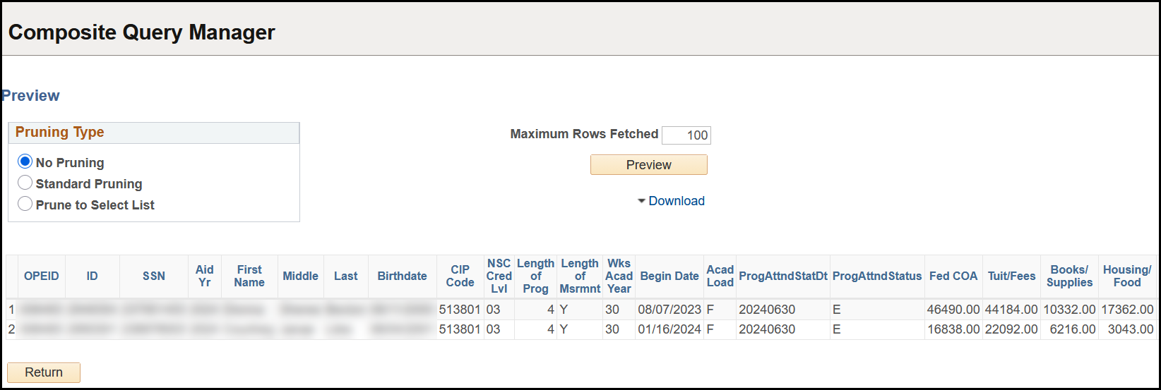

  • 23.  RE: Follow Up to "Using Composite Query - Demonstration and Discussion" (07/30/2025)
    Posted 02-05-2026 02:47 PM
    Hi all,
       I am wondering if this is everyone's experience or if there is something I'm missing.  When running a composite query to HTML, my browser first downloads an actual .html file to my local device.  When I click on that file it opens in my browser (as that is how I have told it to handle that file type) but I wonder if there is a way to skip the "middle man" and have it simply open a new browser tab?
    Thanks,
  • 24.  RE: Follow Up to "Using Composite Query - Demonstration and Discussion" (07/30/2025)
    Posted 02-05-2026 03:39 PM
    Hey Scott
    That is not my experience.  After opening a Composite Query, I hover over the gear icon, and then click Run/Preview.
    The query results then display for me directly on an HTML page, just like they do in 'regular' Query Manager.
    I am not sure if there is configuration that controls this somewhere, but I will look to see if I can find anything.
    Keep us posted!
  • 25.  RE: Follow Up to "Using Composite Query - Demonstration and Discussion" (07/30/2025)
    Posted 02-05-2026 04:05 PM
    Hey Tom,
      Thanks for the response.  It may be relevant to note that I am running the composite query through Composite Query Viewer rather than Manager.
  • 26.  RE: Follow Up to "Using Composite Query - Demonstration and Discussion" (07/30/2025)
    Posted 02-05-2026 05:43 PM
    How interesting.  When I used the Composite Query View, it is working exactly how it is working just as you describe above. So, that seems to be "Working As Designed".
    This has been a great thread for learning new stuff.
