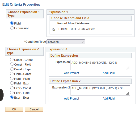

    It is very possible that I am overthinking this one, but I am writing a query for a user that wants to see all active students who will be turning 21 years old within the next month, and they want the query to be scheduled to run on the 1st of every month.
    In its current configuration, it will pull in students with birthdays coming up within the next 30 days (excluding those with birthdays on the date of the run), but is there a better way to do this that will account for months with less than 30 days (February, including leap years) and those with more (July, August, etc.)?
    Since the report is going to be used as an email distribution list, it will duplicate some students (those with birthdays on March 2 would appear on both the February and March reports), and based on my testing, if it runs on the 1st of every month, it will miss anyone with a birthday on the 1st or 31st of the month.
    Current criteria:
    Thank you in advance!

    I think you can get away with continuing with your current criteria set up as pictured above, but instead of using the +30 outside of add months, put and + 1 inside of it?  So the 2nd expression would become
    ADD_MONTHS(SYSDATE, -12*21 + 1)

    Also, it appears that Scott Nishizaki's suggestion would work, perhaps with less modification to the original user query:
    AND A.BIRTHDATE
      BETWEEN ADD_MONTHS(SYSDATE, -12*21)
          AND ADD_MONTHS(SYSDATE, -12*21 + 1)
