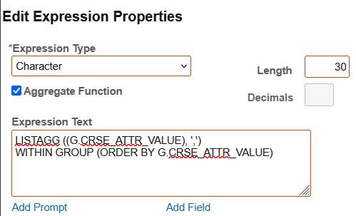

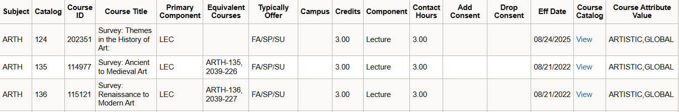

    I'm working on a query to identify a list of courses in the course catalog with a GE course attribute (CRSE_ATTR). I created a LISTAGG expression to list the Course Attribute Value (CRSE_ATTR_VALUE) all on one row instead of multiple rows, but I am getting a CLOB error message. Here is my expression:
    What am I missing in this expression?

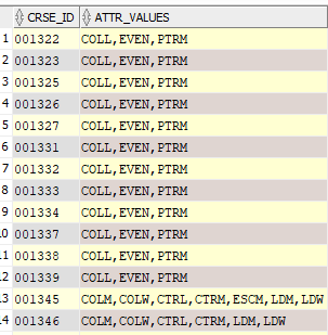

    Without seeing the full SQL I am guessing a bit. It does look like you have an extra bracket in that expression (after LISTAGG)
    This SQL works for me.
    select a.crse_id, listagg(a.crse_attr_value,',') within group (order by a.crse_attr_value) as attr_values
    from ps_crse_attributes a
    where a.effdt = (select max(effdt) from ps_crse_attributes a_ed
                     where a_ed.crse_id=a.crse_id
                     and a_ed.effdt<=SYSDATE)
    and a.crse_attr='EAA'
    group by a.crse_id
    order by 1

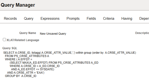

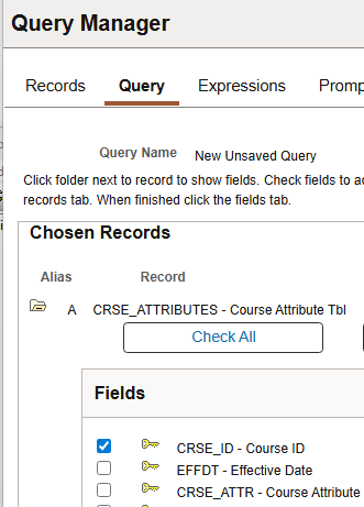

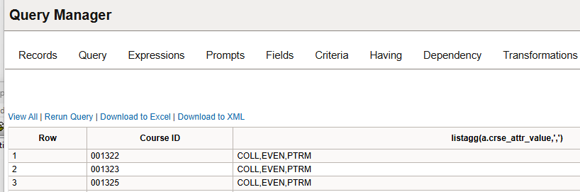

    Actually, the brackets are fine.  Seeing Normalungelo's reply, I did quickly build a PSQuery using my SQL.
    It did run okay. Maybe post your full SQL from PSQuery to see if something else is in there causing your error.

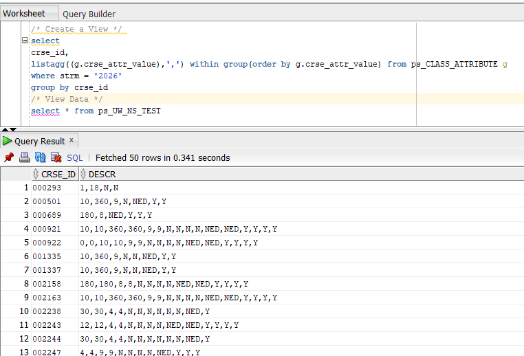

    Posted 03-19-2026 04:46 AM
    It does not look like you can directly use advanced Oracle functions like
    LISTAGG(...) WITHIN GROUP (ORDER BY ...) in the standard query UI. The workaround would be to create a View and use that view to select the required output.
