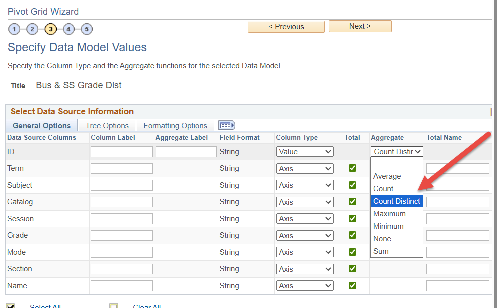

    You are right, the D table is the culprit.  When I add that record, that is when I get more rows to be "counted" upon. I did find the pivot grid in PS that has "Count Distinct", but I can't get that to work either! First screenshot.

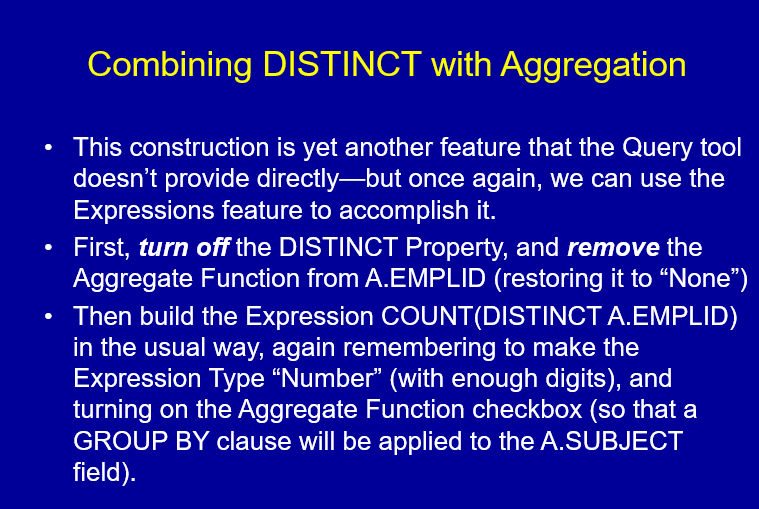

    I did find a PP from 2006 that says I can write an expression.  But I am trying to avoid expressions because Pivot Grids in PS don't like them.  I can go after a view and try to build my Pivot Grid from the view. But I'm trying to build this pivot grid without any help from the outside, just to challenge myself, and this isn't a priority.  2nd screenshot and attaching the PP.
    I'm playing with Subqueries to see if I can get that to work to make it distinct, but I think I've worn out my brain at this time and need to get some lunch. Just in case you are interested in Pivot Grids in PS, attaching that PP too from 2017.
    First Screenshot:
    Second Screenshot:

    Just in case somebody needs it, I got this expression to calculate correctly:
    Count (DISTINCT A.EMPLID)
    Looks like when you use the distinct checkbox, it puts it on the outside.
