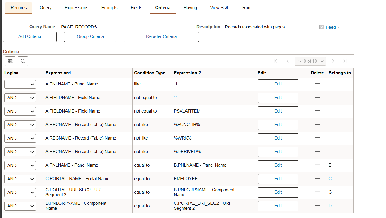

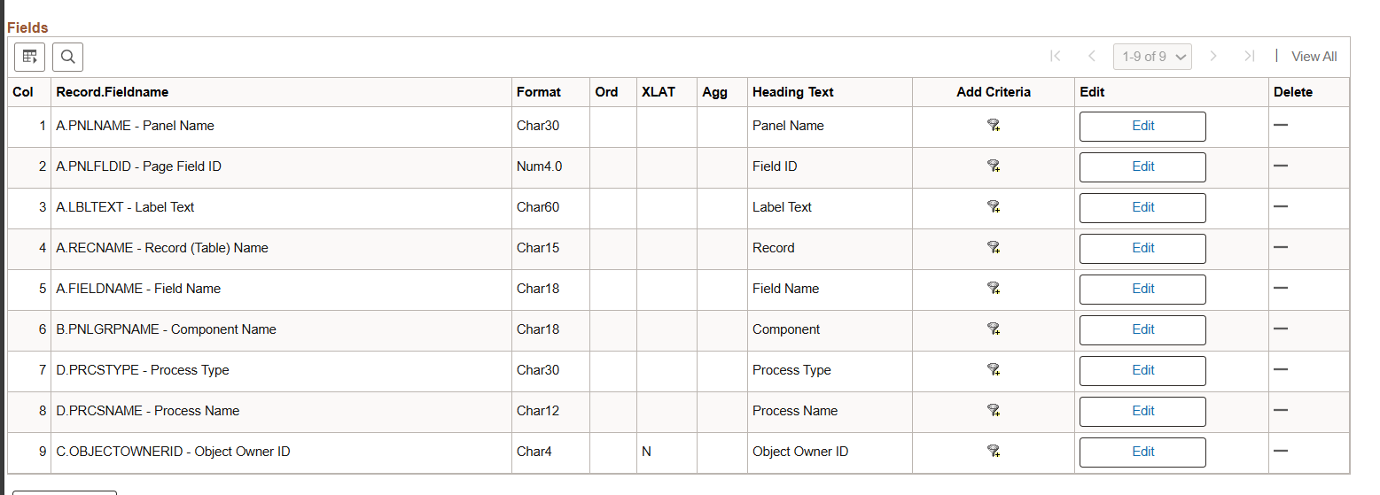

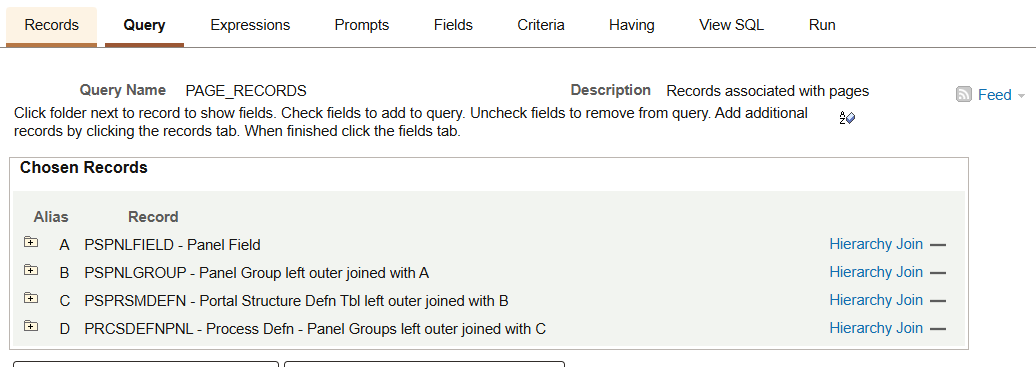

    I worked on this a few hours ago and it seems to be ok-ish but I welcome feedback:
    SQL:
    SELECT DISTINCT A.PNLNAME, A.PNLFLDID, A.LBLTEXT, A.RECNAME, A.FIELDNAME, B.PNLGRPNAME, D.PRCSTYPE, D.PRCSNAME, C.OBJECTOWNERID
      FROM (((PSPNLFIELD A LEFT OUTER JOIN  PSPNLGROUP B ON  A.PNLNAME = B.PNLNAME ) LEFT OUTER JOIN  PSPRSMDEFN C ON  C.PORTAL_NAME = 'EMPLOYEE' AND C.PORTAL_URI_SEG2 = B.PNLGRPNAME ) LEFT OUTER JOIN  PS_PRCSDEFNPNL D ON  D.PNLGRPNAME = C.PORTAL_URI_SEG2 )
      WHERE ( A.PNLNAME LIKE :1
         AND A.FIELDNAME <> ' '
         AND A.FIELDNAME <> 'PSXLATITEM'
         AND A.RECNAME NOT LIKE '%FUNCLIB%'
         AND A.RECNAME NOT LIKE '%WRK%'
         AND A.RECNAME NOT LIKE '%DERIVED%')
    Nicole Apostola
    Payroll and Financial Systems Analyst
    Princeton University
    na2344@princeton.edu
