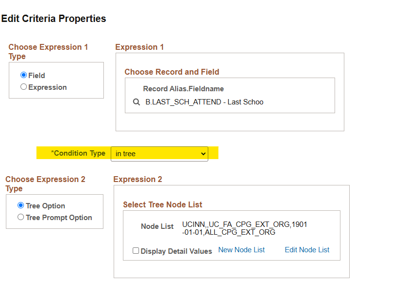

    Do you mean in PS Query?
    You can do "in tree" and then you don't have to do the joins manually to the tree tables.
    For example:
    If I need to look at ranges, I connect directly to the tree records.  A lot of my trees are very basic and is just a list so to speak so if I just need to know if something is in the list, I'll use the in tree or not in tree function.
    Is this what you are asking?

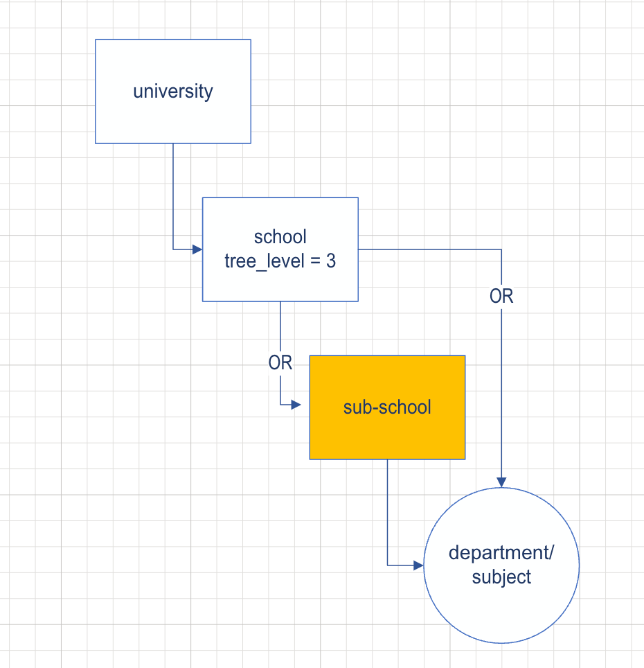

    As someone at an institution with a similar setup, I'm going to guess Cho is being asked to report the school associated with each plan (right ?).  We never found a better way to do this than navigating the tree unfortunately, so we created a SQL view to do it for us so that at least we didn't have to manually add it to the PS Query.
  • 4.  RE: Querying tree tables like ACAD_ORGANIZATION
    Posted 02-07-2025 06:02 PM
    Edited by Cho Kim 02-07-2025 06:02 PM
    That's correct, Scott. My end goal was to report the school associated with each academic plan. The diagram below depicts how our academic organization structure is laid out. Sometimes there is a "sub-school" folder where querying the parent node information returns the sub-school and not the actual school the academic org resides in. Thanks for the idea about creating a SQL view, curious what that SQL looks like if you can share it!

    Scott Nishizaki beat me to it! The SQL he shared is probably the 5th iteration over the past few years, as I attempted to learn hierarchical queries to loop through the PSTREENODE table and adjust for however many levels we end up having on the tree. A few things to point out:
    The "DATES" common table expression is just used to get a list of all effective dates where either the ACAD_ORG_TBL changed, or the tree that we use for tracking acad structure over time. You'll notice that we created a separate ACAD_ORG_REPORT tree for this historical reporting, whereas we don't try to retain the full effective-dated history on the delivered ACAD_ORGANIZATION tree used for security.
    Our departments are extremely granular, sometimes split by Career code, so we are not joining Subjects to the tree. We just use the "dynamic flag".
    Some schools are nested within colleges and some schools are not, so in order to find top-level college/school and second-level college/school where applicable, we have to test the descriptions against naming conventions... this requires some maintenance over time, but it's worth it for us in the long run.
    Basically if you were to replace the tree name with yours (probably ACAD_ORGANIZATION)
    WHERE TREE_NAME = 'ACAD_ORG_REPORT'
    And update your root tree node here
    START WITH TREE_NODE = 'APU'
    Then you should at least get some data out, and you can start tweaking with the rest of the hard-coded stuff, etc. Have fun! :)
