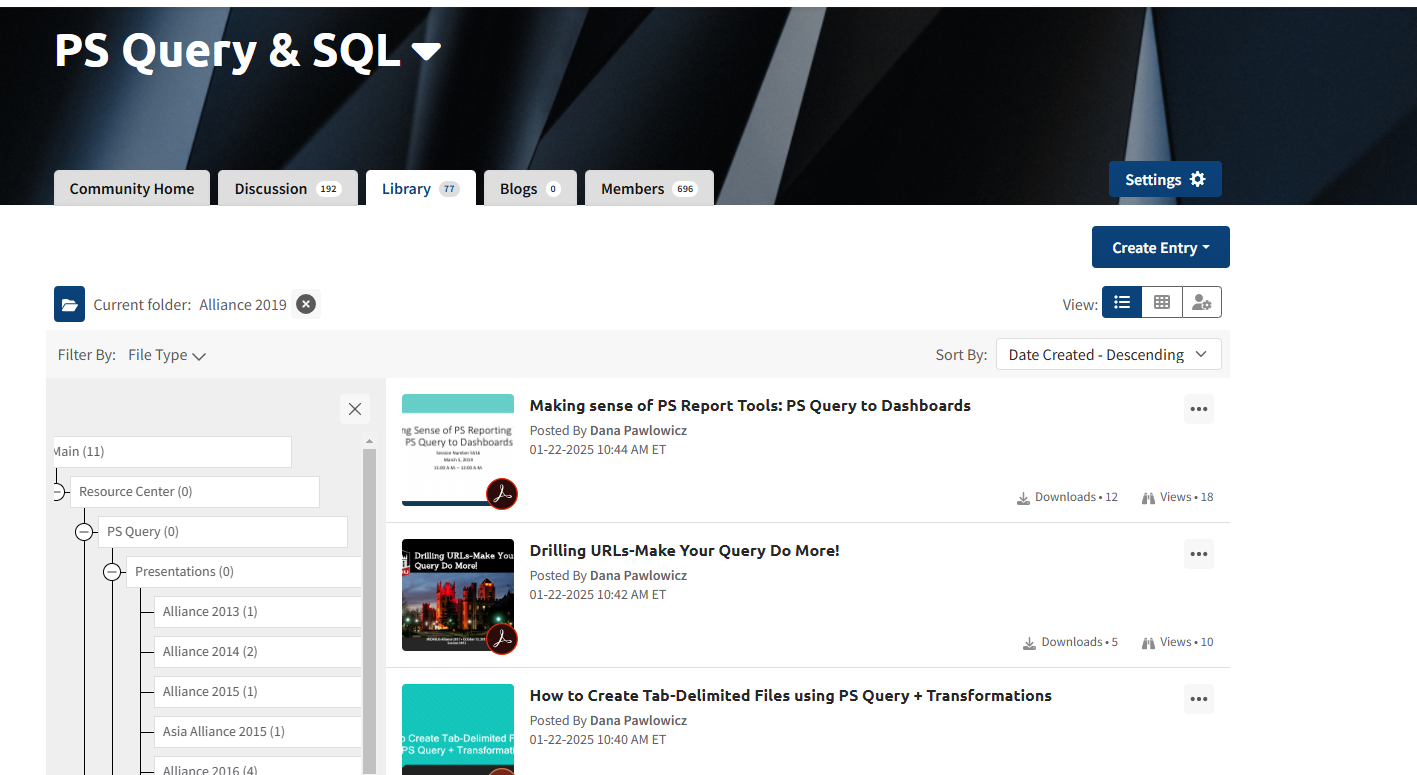

  • 11.  RE: Subtotals/Totals in PS/Query
    Posted 02-13-2025 10:36 AM
    Even if you didn't go to Alliance 2019, it's in the library.  You have to drill down to get to it.  Click on the discussion tab, then double-click on Resource Center, then PS Query, then Presentations.  There are folders out there for a bunch of Alliance years, plus some regional conferences.  I recommend looking at all of them and download what you think sounds interesting.
    Also, if you think something is missing, please reach out to Dan (daniel.labrecque@unlv.edu) or myself (pawlowdj@ucmail.uc.edu) and we'd be happy to get it into the library.  There are 6 presentations from Alliance 2019 in the library and this one is included.
  • 12.  RE: Subtotals/Totals in PS/Query
    Posted 02-13-2025 10:39 AM
    Oh, good grief.  Click on the library tab, not discussions.  I'm sorry.
    Click on the library tab, then double-click on Resource Center, then PS Query, then Presentations.  There are folders out there for a bunch of Alliance years, plus some regional conferences.  I recommend looking at all of them and download what you think sounds interesting.
