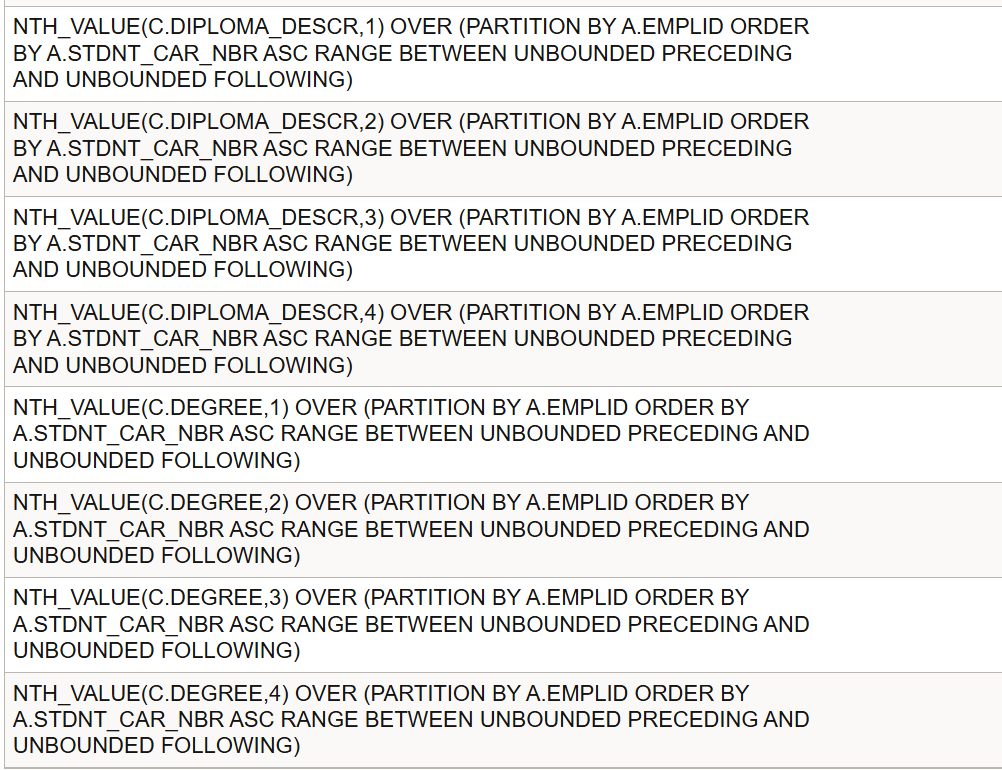

  • 7.  RE: 2nd most recent row for a table with effective date and effective sequence
    Posted 04-30-2026 11:42 AM
    I just used NTH value to try to get multiple degrees onto our NameCards for Commencement.  Seems to be working.  Here are my expressions:

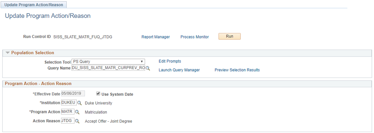

    Posted 04-28-2026 05:36 PM
    This is the SQL from a PS Query I have which checks the current row and the immediately previous row for particular values.  Following the SQL are screen shots of the run control record and parameters which I am using.  The term range referred to is coming from the File Parser Conversion Definition table.  Given some of the complexity, we built a view (DU_ADMA_CURPREV) to assist and that SQL follows the screen shots.
    Hope this helps you.

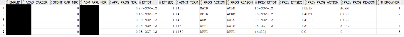

  • 10.  RE: 2nd most recent row for a table with effective date and effective sequence
    Posted 04-29-2026 10:49 AM
    That view brings back data from the current row and the previous row - flattening it into one row, thru the entire history of the AD stack.  Screen shot of one entry is below.  You can see that as it goes back in time that the initial stack entry has "nothing" for a previous (row 5 in this example).
    The evaluation of what I need for my process to matric happens in the first set of SQL in my initial email.
