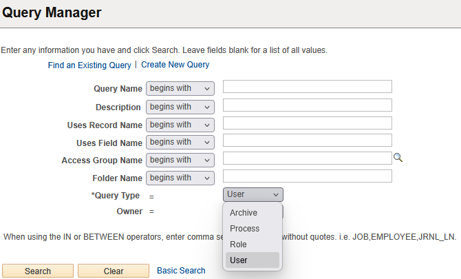

    • How do you determine if the record is public or private? I saw a query type of 1 or 0, but for some reason everything comes back as 1 for me, even though I'm using the correct record and field.

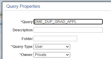

  • 5.  RE: Auditing Queries that output sensitive data
    Posted 11-07-2025 08:41 AM
    Hi -
    QRYTYPE is referring to the "Query Type" field which you can select on via the advanced search record display
    ...and view within the Properties link in the query.
    The value of 1 refers to "User".
