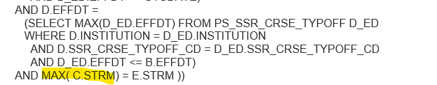

    I'm working modifying a courses last offered query by adding the term description from the TERM_VAL_TBL. Unfortunately, this isn't working as expected because I'm receiving an 'Error in running query because of SQL Error, Code=934, Message=ORA-00934: group function is not allowed here (50,380)' message. I think this is because CLASS_TBL is looking for the maximum STRM - when I remove the criteria it runs successfully, but for every term. Any suggestions for how I can resolve this error?

    The problem is that anytime you use max as an aggregate on a field, it uses it EVERY place that field is referenced.  This results in the following SQL problem...
    Which isn't allowed.  The easiest fix is to not use max on the actual field, but to create an expression with the aggregate box checked, and put in max (c.strm) as the expression.  Use that field, and you should be ok.  I think.  If I'm remembering correctly...

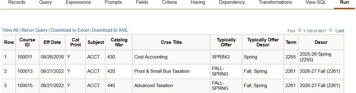

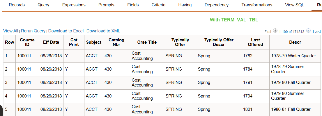

    Thanks Vic. I initially had it set as an expression as you noted, but the issue is that the term table will display the description for every term the class was offered, ignoring the expression. Here i a screen capture of what I saw when I used the expression of max(STRM) with and without the TERM_VAL_TBL.
    Notice how below, it ignores the expression and provides the description for all terms.
