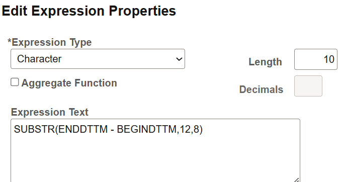

  • 3.  RE: Elapsed Time / Timestamp Differences - Any (Easy) Expresssions?
    Posted 04-14-2026 12:21 PM
    I got this from Jeffie Brooks to break the time difference between 2 timestamps into  hours:minutes:seconds.   You likely can use datediff also.
    SUBSTR(ENDDTTM - BEGINDTTM,12,8)
