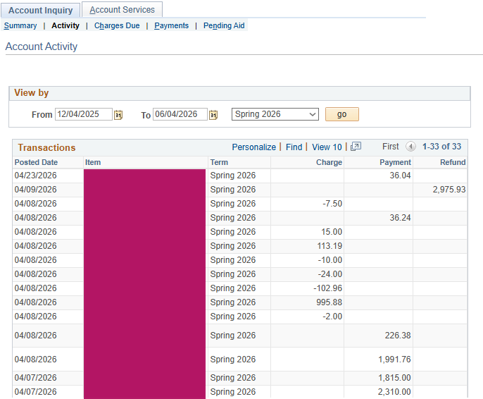

    Hello Friends,
    We are working on a project where the student account activity details (from the student center) need to be shared with a third-party vendor so they can replicate this detailed summary in their system.
    I am very new to writing queries for student financials and have been diving into the records and data over the last couple of days. I know that I need to use ITEM_SF and ITEM_LINE_SF, and I can see the matching data (Posted Date, Item, Term, Charge, Payment, Refund).
    The struggle now becomes how to align the information to the appropriate column, for "Charge", "Payment", "Refund." My experience in PS tells me that there must be some type of code or identifier that I need to tie in to determine how these amounts should apply to the columns. But I don't know where to start with this.
    Any guidance is appreciated.

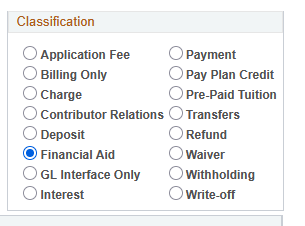

    Hey Lidia!
    I think the information you're seeking will be found in the ITEM_TYPE_TBL.  The field ITEM_TYPE_CD corresponds to the "classification" area on the SF setup, as shown below:
    An ITEM_TYPE_CD of P = Payment, C = Charge, and R = Refund, at least it is at our institution.  I think you if did an outer join of this information to the ITEM_SF table, matching it to the ITEM_TYPE field, then you'll be able to get these indicators.

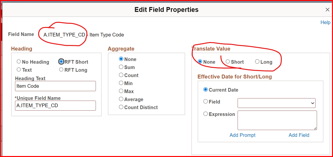

    PS Query will do this for you automagically if you select a translatable field in your query, it just takes a couple clicks in Query Manager.
