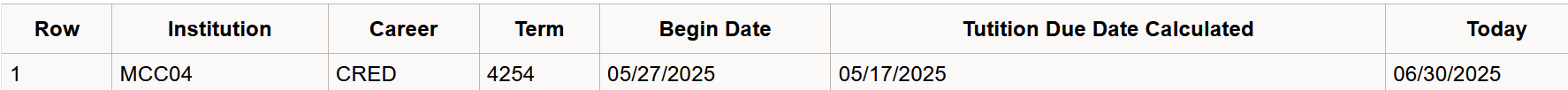

    I am working on a query to provide a calculated due date.  I have gotten all my dates to return in their columns, but the Expression to return the ultimate a single date is escaping me!
    To calculate the "due date" as 10 days prior to the TERM_BEGIN_DT (use field as CALC_DUE_DT in Expression):  %DateAdd(%datein(A.TERM_BEGIN_DT), -10)
    To get today's date (one of many ways, again in Expression): %CurrentDateIn
    SQL of query working thus far:
    SELECT DISTINCT A.INSTITUTION, A.ACAD_CAREER, A.STRM, TO_CHAR(A.TERM_BEGIN_DT,'YYYY-MM-DD'), ((TO_DATE(TO_CHAR(A.TERM_BEGIN_DT,'YYYY-MM-DD'),'YYYY-MM-DD')) + ( -10)), TO_DATE(TO_CHAR(SYSDATE,'YYYY-MM-DD'),'YYYY-MM-DD')
      FROM PS_TERM_TBL A
      WHERE ( A.INSTITUTION = :1
         AND A.ACAD_CAREER = :2
         AND A.STRM = :3)
      GROUP BY  A.INSTITUTION,  A.ACAD_CAREER,  A.STRM,  A.TERM_BEGIN_DT,  TO_DATE(TO_CHAR(SYSDATE,'YYYY-MM-DD'),'YYYY-MM-DD')
    Next Step - do the comparison and return a single date!

    Would you believe I tried this same Expression?
    WHERE ((%CurrentDateIn) > (%DateAdd(%datein(A.TERM_BEGIN_DT), -10))) THEN %DateOut(%DateAdd(%datein(A.TERM_BEGIN_DT), -10))
    ELSE %CurrentDateIn
    Oh, but I said WHERE...not WHEN - that is what comes from reading SQL based info!  No wonder Query was expecting the FROM somewhere else (smh).
    Yes, Dan's SQL works - as does Tim's.  Of other note, my alligators are eating the wrong part of that statement for what I really need (dates, dates, dates, give me a fig newton already).  Given today is June 30 and the "10 days prior" was back in May, I really should return the June date as it's due today (well midnight, but I'm not going to quibble about is it a coach or a pumpkin - get home/pay before curfew or face the dropped class).
    It's like asking your co-pilot "Do I turn here?" and they say "Yes, right here!" when "right here" is not RIGHT but LEFT...so I was left in an endless circle from my own syntax error where I ended up nowhere!   Thank you both for the assists!

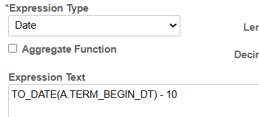

    I think I ran into the same problems you're describing when trying to recreate this in Query Manager. As we all know, this tool automatically casts dates as CHAR, and that automatically-inserted logic is messing us up. For example, when I write this in an expression (which would totally work as raw SQL):
    It produces this invalid SQL:
    TO_CHAR(A.TERM_BEGIN_DT,'YYYY-MM-DD') - 10
    If I instead write this expression:
    It produces this SQL:
    TO_DATE( TO_CHAR(A.TERM_BEGIN_DT,'YYYY-MM-DD')) - 10
    ...which produces valid results as below.

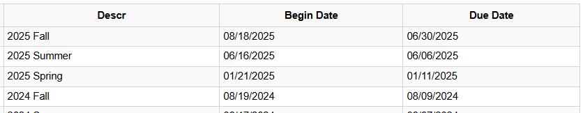

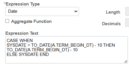

    I'm then able to extend that to what I think is the conditional logic you're looking for.
    ...which gets rewritten as:
    CASE WHEN
    SYSDATE > TO_DATE( TO_CHAR(A.TERM_BEGIN_DT,'YYYY-MM-DD')) - 10 THEN TO_DATE( TO_CHAR(A.TERM_BEGIN_DT,'YYYY-MM-DD')) - 10
    ELSE SYSDATE END
    ...which produces results as below.

    The case statement works but I prefer %currentdatein to sysdate because sysdate contains date AND time
    CASE WHEN SYSDATE > TO_DATE( TO_CHAR(A.TERM_BEGIN_DT,'YYYY-MM-DD')) - 10 THEN TO_DATE( TO_CHAR(A.TERM_BEGIN_DT,'YYYY-MM-DD')) - 10 ELSE SYSDATE END
    Another useful SQL function is GREATEST (LEAST) in this example
    GREATEST(%currentdatein, TO_DATE( TO_CHAR(A.TERM_BEGIN_DT,'YYYY-MM-DD')) - 10)
