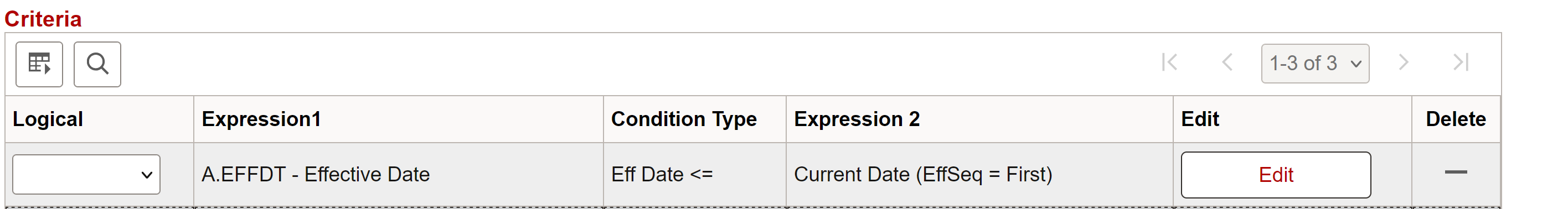

    Hello Rachel,
    I think you can change the EFFDT criteria to:
    By default it is set to Current Date (EffSeq = Last).

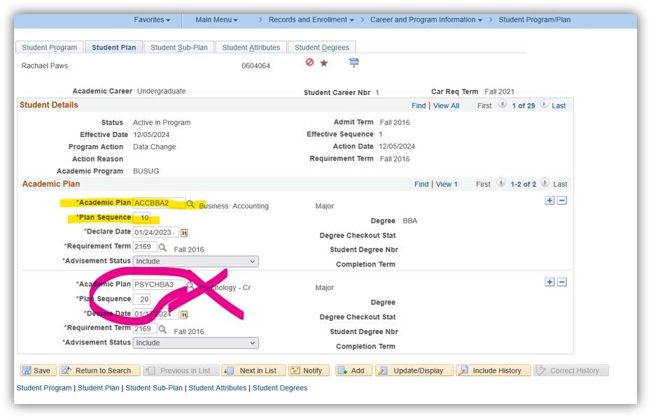

    Posted 02-24-2025 12:51 PM
    Sorry, I should have been more clear. If a student has more than one plan, I want the one where, for this single career number, the PLAN_SEQUENCE is the minimum sequence. The dates there (for declare date or eff date) don't always equate the minimum plan sequence number. For example, I want to return ONLY the ACCBBA2 plan code, because it's the minimum sequence number.

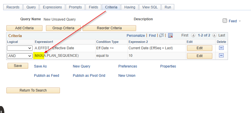

  • 5.  RE: Minimum Plan Sequence
    Posted 02-24-2025 01:13 PM

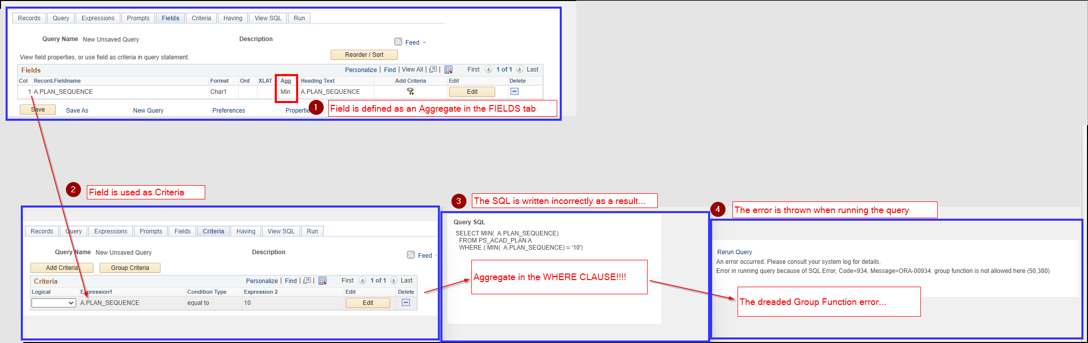

    And every time I try to set that to MIN, I get this. So I'm sure I'm missing something in how I build that out.

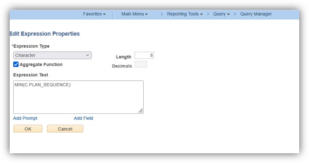

  • 8.  RE: Minimum Plan Sequence
    Posted 02-24-2025 01:25 PM
    Hi Rachael,
    That error usually comes from having criteria set in the CRITERIA tab for a field that you have defined as an aggregate. If you look at your CRITERIA tab and see something like this:
    That is not normally allowed. There are a couple of different ways that this usually happens:
    1. Check your expressions for the aggregate flag. If you are using one of the aggregate functions, its important that this flag is checked so that the query knows how to group things properly, and put your criteria in the HAVING clause.
    2. Check your FIELDS tab for any aggregate values. These create hidden errors and the MAX(), MIN(), SUM() etc. values aren't shown in the criteria tab. BUT if you view the SQL, you can see that they are written out in the SQL. Because of this, I tend not to define aggregates in the FIELDS tab, and instead define them in the expressions tab most of the time. This happens more often with Subqueries.
    TL;DR Try to define your MIN() sequence number in an expression and use that as your field returned in the subquery instead of defining the aggregate in the FIELDS tab.

  • 9.  RE: Minimum Plan Sequence
    Posted 02-25-2025 06:10 AM
    Rachel,
    This error will occur when you have criteria on the field that you use in the min aggregation. You probably have something in your sub query criteria on X.PLAN_SEQUENCE. The work around is to create an expression of X.PLAN_SEQUENCE then use as field and edit to Min
    Hope this helps

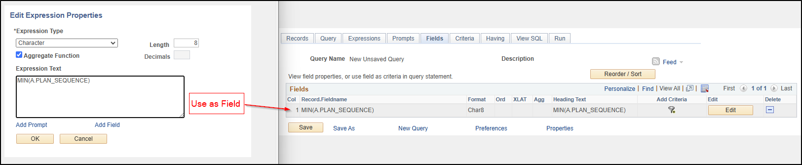

  • 10.  RE: Minimum Plan Sequence
    Posted 02-25-2025 07:34 AM
    This field is an aggregate field but is being used in non-having criteria error happens when the field being used in the sub query aggregate is being used in the criteria tab.
    The work around is to create the field as an expression,
    then use the expression as as field from the Expressions Tab
    then apply your aggregation ... you will notice that there is no description now from the Record.Fieldname because it is an expression

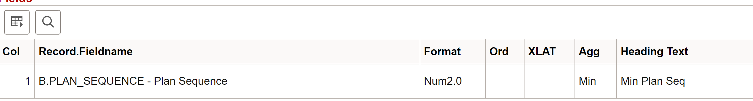

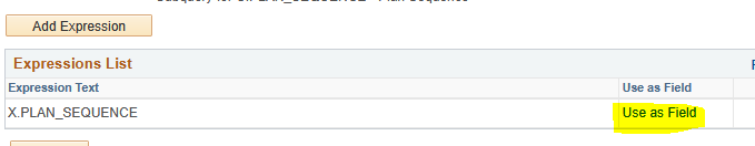

  • 11.  RE: Minimum Plan Sequence
    Posted 02-25-2025 10:11 AM

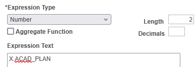

    To add on to what Robert is saying, you could take this solution a step further and define the aggregate within the expression, instead of doing it at the FIELD tab. So it would look like this:
    I strongly recommend doing it this way, instead of defining aggregates in the FIELD tab. This is because it can get real buggy if you try to use that same field for any criteria in the query later on. It's pretty insidious too, since the only way to really know why the error is happening is to look at the SQL!
    The example below shows what is happens when this error occurs:
    You could say that the PSQuery just isn't having it, when this error occurs... but then your friend will groan and call you a nerd...
    On flip-side, if you were to do the same thing, but instead define the aggregate within the expression (And NOT add the aggregate in the FIELDS tab), PSQuery will be smart enough to write the correct SQL statement and put your aggregated field nicely into the HAVING clause, and no error should be thrown.
    Ultimately, understanding what the heck is going on when working with aggregates is hard, and when PSQuery starts writing the underlying SQL in unexpected ways, it just makes it that much harder.
    Hoping this helps!

    Sent: 2/24/2025 12:43:00 PM
    From: Daniel Labrecque
    Subject: RE: Minimum Plan Sequence
    Hello Rachel,

  • 14.  RE: Minimum Plan Sequence
    Posted 02-25-2025 11:16 AM
    i do this sub query all the time successfully ... here is my sub query criteria where I is ACAD_PLAN in the sub query and H is ACAD_PLAN in the Top Level of Query
    Logical
    Expression1
    Condition Type
    Expression 2
      I.EMPLID - Empl ID equal to H.EMPLID - Empl ID
    AND I.ACAD_CAREER - Academic Career equal to H.ACAD_CAREER - Academic Career
    AND I.STDNT_CAR_NBR - Student Career Nbr equal to H.STDNT_CAR_NBR - Student Career Nbr
    AND I.EFFDT - Effective Date equal to H.EFFDT - Effective Date
    AND I.EFFSEQ - Effective Sequence equal to H.EFFSEQ - Effective Sequence
    Select the field and Edit to Min
