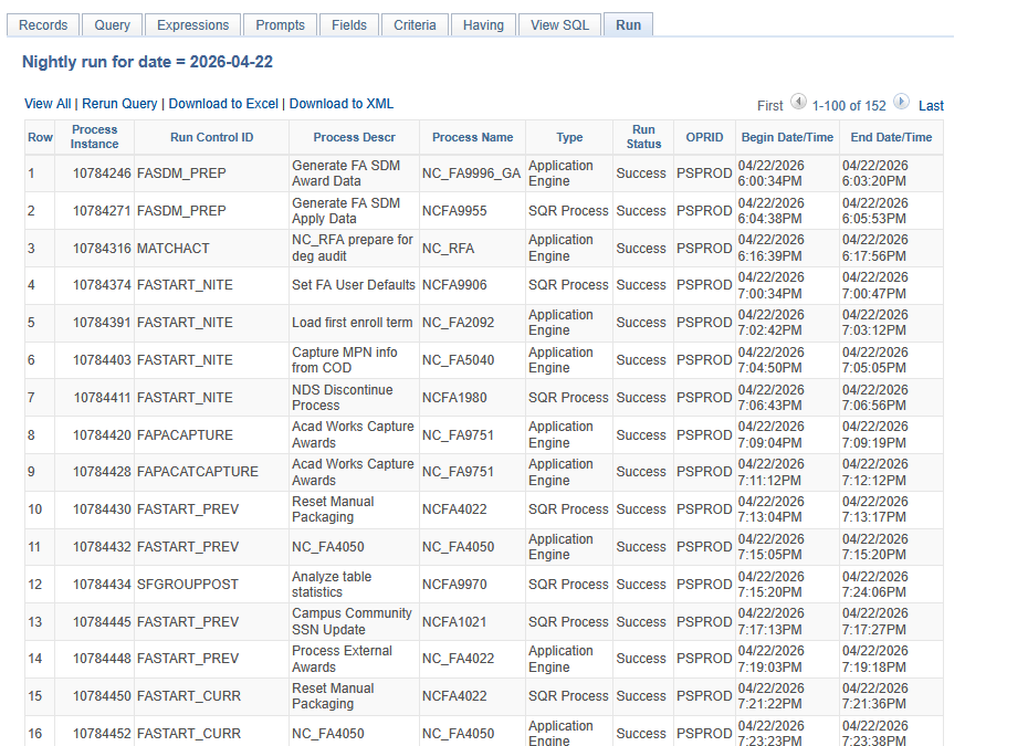

    We have a query that we run daily to see the status of our nightly job processes.  Not sure it gets you everything you're looking for, but maybe it'll be a starting point for you.  The SQL is below followed by a screenshot of what it looks like in PS Query.
    SELECT B.PRCSINSTANCE, B.RUNCNTLID, A.DESCR, B.PRCSNAME, B.PRCSTYPE, B.RUNSTATUSDESCR, B.OPRID, TO_CHAR(CAST((B.BEGINDTTM) AS TIMESTAMP),'YYYY-MM-DD-HH24.MI.SS.FF'), TO_CHAR(CAST((B.ENDDTTM) AS TIMESTAMP),'YYYY-MM-DD-HH24.MI.SS.FF')
      FROM PS_PRCSDEFN A, PS_PMN_PRCSLIST B
      WHERE ( A.PRCSTYPE = B.PRCSTYPE
         AND A.PRCSNAME = B.PRCSNAME
         AND TO_CHAR( B.RUNDTTM, 'YYYY-MM-DD-HH24') >= TO_DATE(:1,'YYYY-MM-DD') || '-17'
         AND TO_CHAR( B.RUNDTTM, 'YYYY-MM-DD-HH24') <= TO_CHAR((TO_DATE(TO_DATE(:1,'YYYY-MM-DD'),'YYYY-MM-DD') + 1), 'YYYY-MM-DD') || '-10'
         AND ( B.RUNCNTLID LIKE 'FA%'
         OR B.PRCSNAME LIKE 'NC%FA%'
         OR B.PRCSNAME LIKE 'FAP%'))
      ORDER BY 8

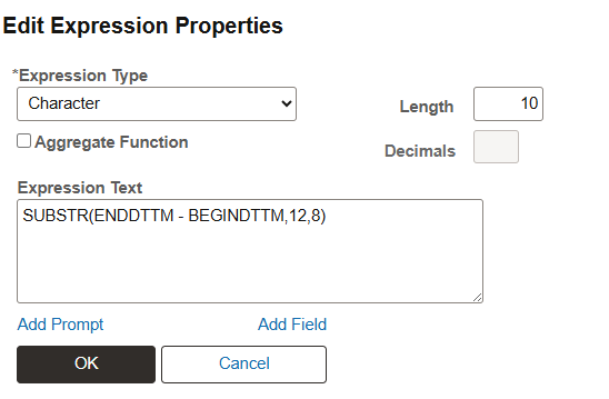

    I don't have one that looks for overlapping jobs but this one looks for long running.  The prompt is # of days.  I defaulted mine to 1 day but can change it.  It gives you anything that was longer than 15 minutes.
    SELECT DISTINCT A.PRCSINSTANCE, A.PRCSTYPE, A.PRCSNAME, A.JOBNAMESRC, A.RUNCNTLID, TO_CHAR(CAST((A.BEGINDTTM) AS TIMESTAMP),'YYYY-MM-DD-HH24.MI.SS.FF'), TO_CHAR(CAST((A.ENDDTTM) AS TIMESTAMP),'YYYY-MM-DD-HH24.MI.SS.FF'), SUBSTR(ENDDTTM - BEGINDTTM,12,8), A.RUNSTATUSDESCR
      FROM PS_PMN_PRCSLIST A
      WHERE ( A.ENDDTTM > SYSDATE - :1
         AND SUBSTR(ENDDTTM - BEGINDTTM,12,8) > '00:15:00'
         AND A.PRCSTYPE <> 'PSJob')
      ORDER BY 8 DESC

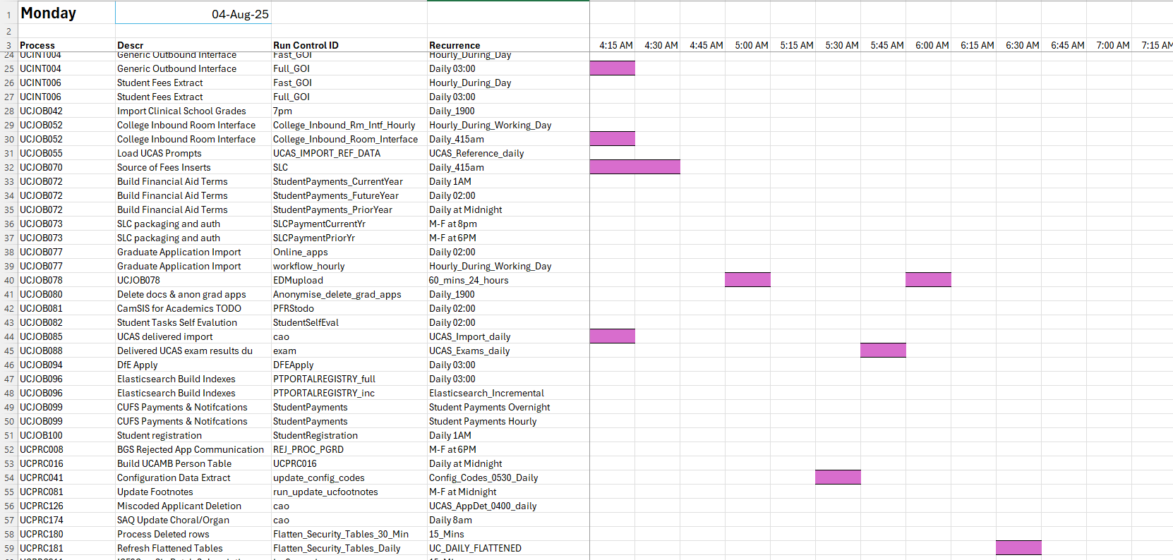

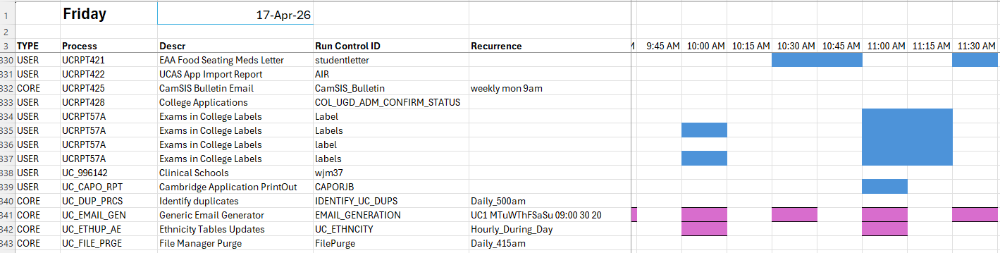

    Last year I was looking at our processes that were running and wanted to see it visually.
    I downloaded data for a 7 day period into a spreadsheet and created a gantt chart.
    I round processing times to a 15 minute block ie. a process that takes 2 seconds is shown as 15 minutes, so not what you would call accurate, but it achieved what I was after.
    If that would be of any use, I can write up how I did it (as long as I made notes!). Would be next week though.
    Thanks
    Daron
    Alliance 2026 Recordings are here!
  • 7.  RE: Process Monitor Evaluation - HELP!
    Posted 04-26-2026 11:35 AM

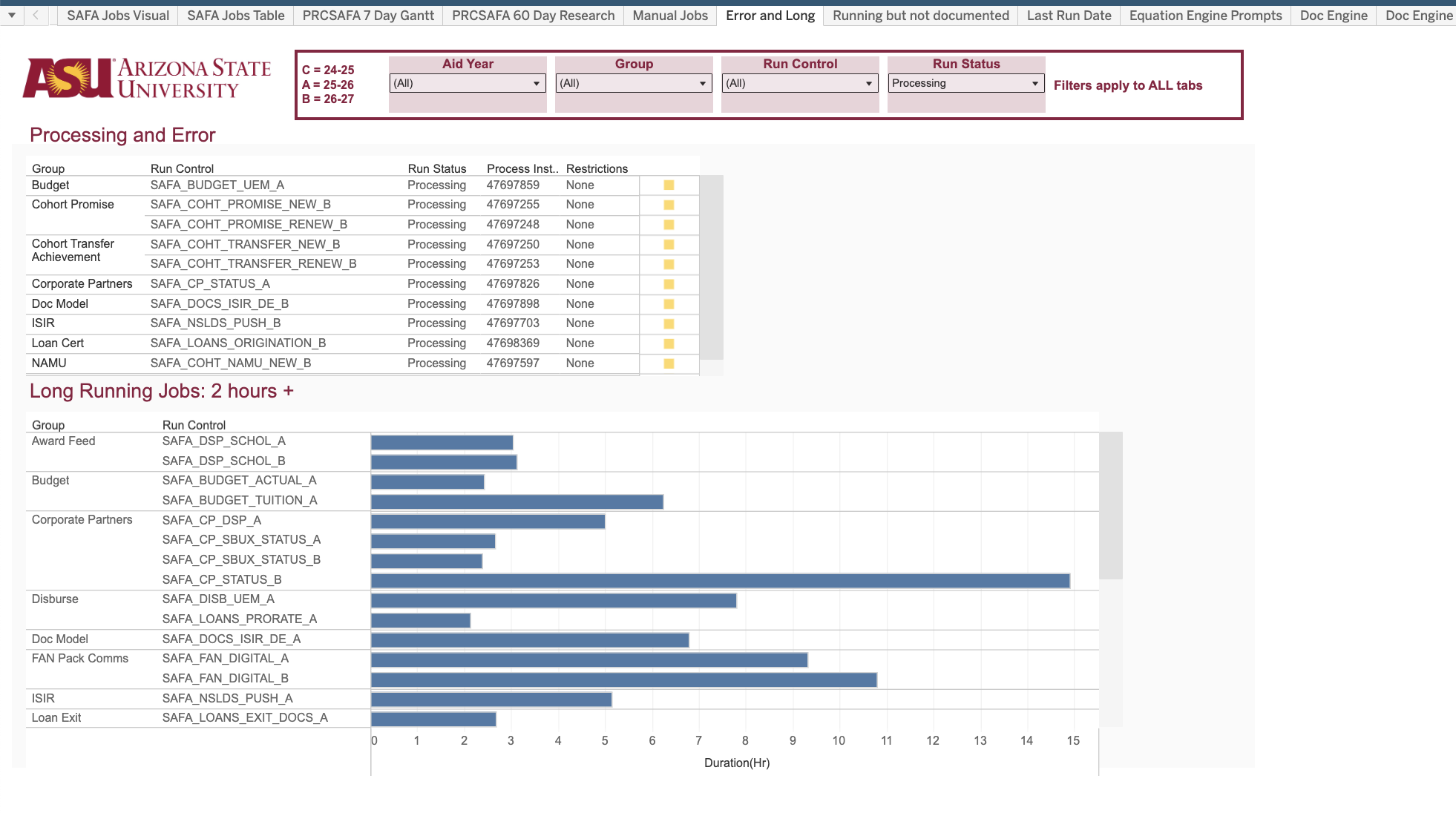

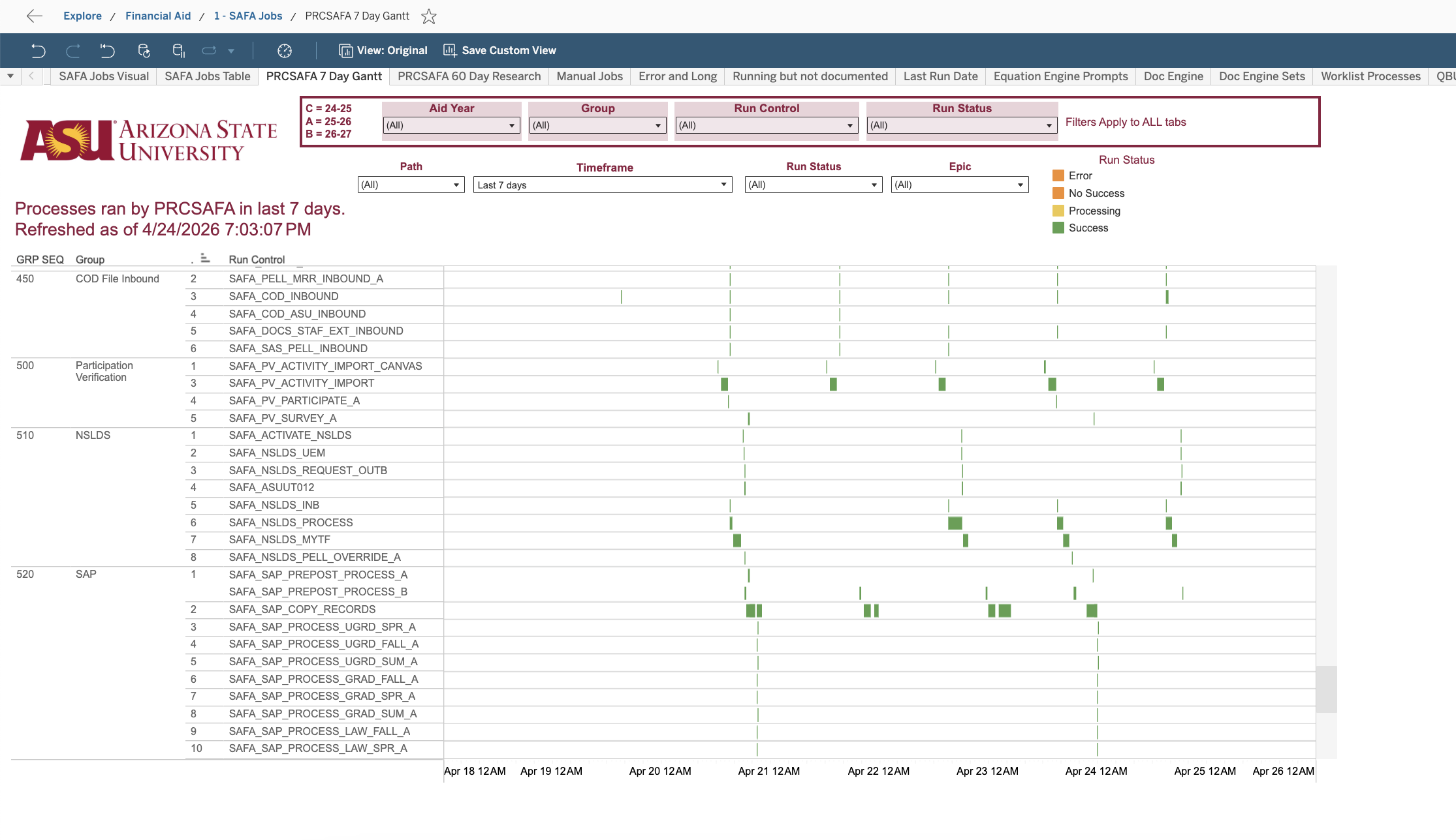

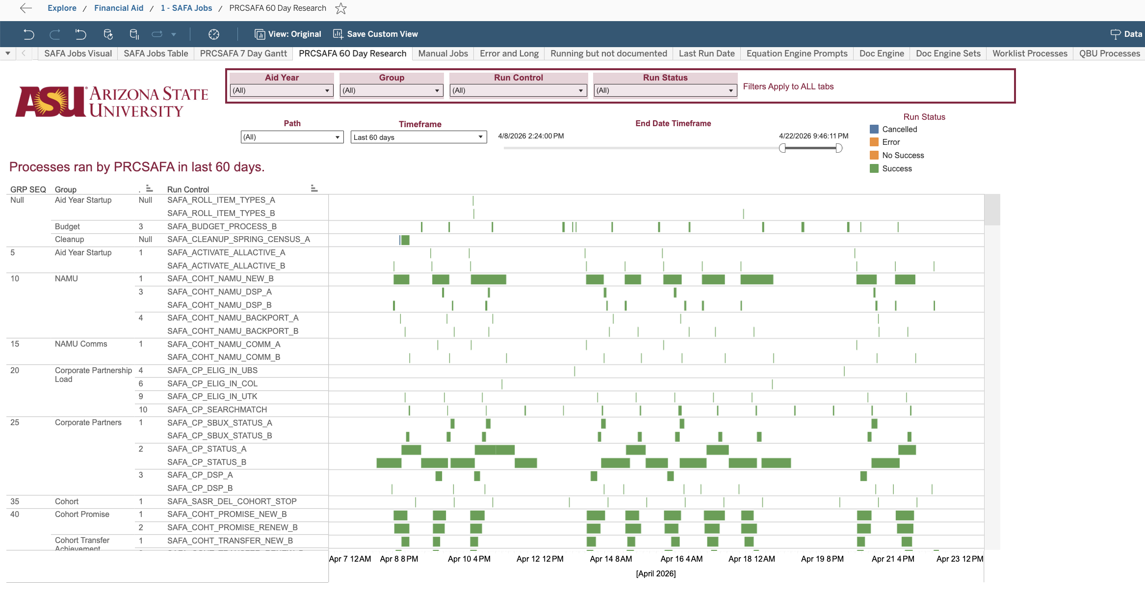

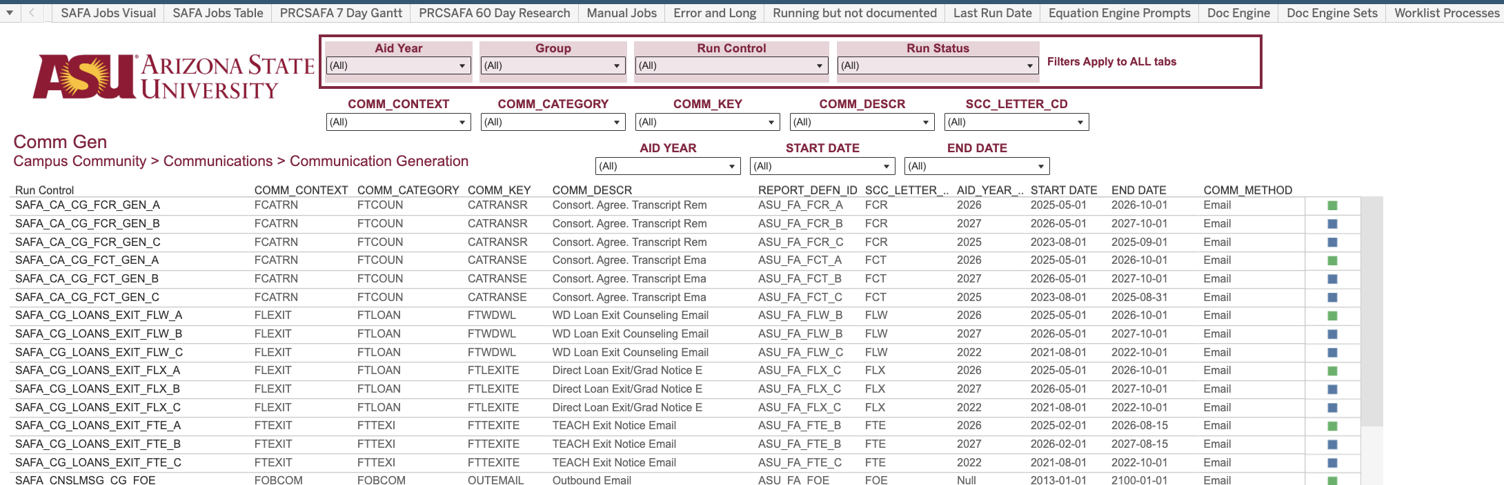

    The Tableau dashboards looks really good.
    For the instructions of my manual/adhoc gantt chart you can do the following.
    1. Copy the attached spreadsheet - BatchScheduleTemplate.
    2. It has 3 tabs. The first will be the data dump of a weeks worth of Process Scheduler.  The second is the Gantt formulas and a look up table. The third is the SQL to populate the other two tabs.
    3. Copy the first piece of SQL into SQL Developer and amend the dates/user as needed. Run it. Copy the results to tab1
    4. Copy second piece of SQL and amend/run. Copy the results into tab2
    5. Change the date filter at the top to match one of the days of the week you have selected.
    6. The Gantt appears.
    I have also attached a video of me doing it for last weeks data.

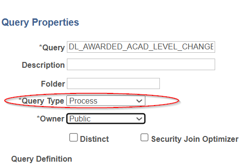

    Hi Daron,
    This is extremely helpful. I was reviewing the SQL and notice that you limit the output to a specific OPRID. Have you ever done this not limited to OPRID?
  • 10.  RE: Process Monitor Evaluation - HELP!
    Posted 04-27-2026 09:26 AM
    If you set the Query Type to Process, you can bypass the OPRID restriction.  Just remember that when searching for this query, you will need to look for it under the Process type.

    Posted 04-27-2026 11:57 AM
    All our core batch processing is carried out by a single oprid.
    If I wanted to track when users were running processes, against the core schedule, I would probably amend the sql statements to split 'CORE' and 'USERS'. Then amend the gantt formulas to give the 'USER' bars a different colour.
    I have tested this quickly (but not thoroughly!)
    You'll need to adjust the template spreadsheet to your needs. The version above is attached.

    Posted 04-24-2026 11:54 AM

    We use Tableau and have developed some pretty great dashboards/pages for monitoring.  It does something similar to what Daron does with his gantt charts.  We have it setup to monitor 7 days and 60 days, and we divide it up by aid year/area/grouped jobs (you can also use the date slider to zoom into particular times).  We have talked about presenting at Alliance but the last few years...well...maybe we get a break from changes next year?  We have some other really awesome Tableaus that @Mario Gorla has developed around stats, process QA, and setup.
    We can monitor setup as well:
    We also have job status and to see visually what is running from process monitor and what has run long:
    Michael Kosak

    Good Morning Micheal - This set of dashboards is very cool!  I would love to learn more about how you put these together, and I definitely agree this would make a really interesting Alliance presentation.
    If an Alliance conference is not in your cards at the moment, I also think this would make a fantastic E-Academy Webinar.  You can submit a Webinar proposal from the E-Academy page, if you have the time to take this on.  Regardless, thank you for sharing your dashboards.
