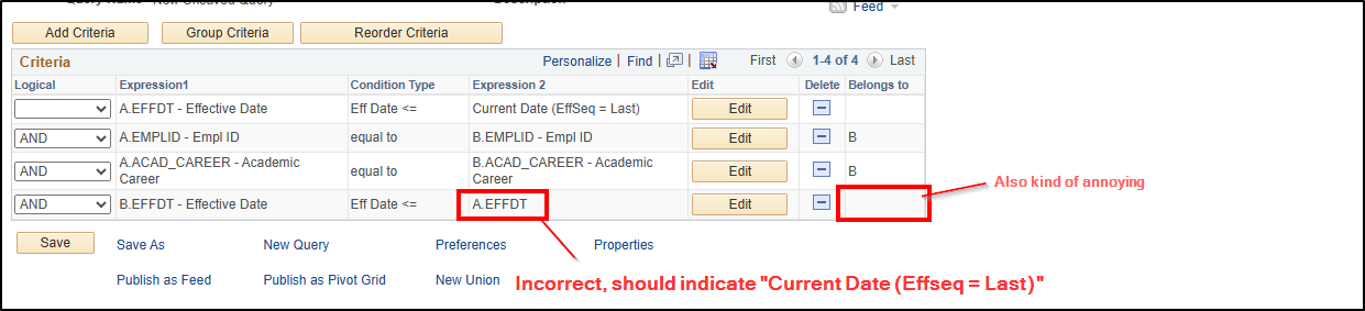

    There is a strange bug that occurs for us in PSQuery, and I wanted to create a post about it for 2 reasons:
    1. To confirm that it isn't something specific to how we are setup that is causing it (we have a lot of mods)
    2. To raise awareness in case it causes issues for other folks
    The Issue: Most of us who work in PSQuery are likely familiar with the automatic subqueries that are written to help return the most recent row in records that have an EFFDT (effective date) field - a feature I am thankful for!  However, I have noticed that when outerjoining two records that both have an EFFDT field, that the automatic logic does not work correctly.  The second EFFDT gets set to <= the first EFFDT instead of being set to <= SYSDATE. Example below:
    This is a screenshot I took after outerjoining the record, PS_STDNT_FA_TERM to  PS_ADM_APPL_PROG - two records with unrelated effective dates. I can't think of many scenarios where this would be the desired outcome.
    Most of the time, you will need to assign the criteria to the correct ON clause, so you can easily fix expression 2 while you are in there. But honestly, it is kind of easy to miss...
    So yeah, are any of you seeing this behavior in your system? I found some instances in our system that look to be the result of this issue in our system. I am attaching the SQL in case anyone cares to run it in SQL developer or your preferred tool.

  • 2.  RE: PSQuery: Outer Joins and Effective Dates Error
    Posted 08-14-2025 10:16 AM
    Yeah, we have that too.  I just know to manually fix it.  And remind everyone to add that outer join.  Not sure why they don't do the outer join part.
    Sometimes regular joins get messed up with effective dates too so I always make sure to double check it.

    Posted 08-15-2025 11:43 AM
    It's been this way for at least 13 years.
    Oracle assumes that the MAX row we want to see is on the main record (A). And we usually would not want to see any row on the outer-joined record (B) that exceeds the EffDt of that row since it would not yet be in effect  (i.e. it would be future-dated as of the EffDt of the row on the main record, for each corresponding employee or student or whatever).
    So, PSQuery creates the autojoined criteria:
    A.EffDt   EffectiveDate<=   Current Date
    B.Effdt   EffectiveDate<=    A.Effdt
    If MAX(A.EffDt) happens to be SYSDATE, then MAX(B.EffDt) will also be SYSDATE  ...but, only where A.Effdt is.
    There are many occasions where always want the most recent data from the B.record no matter what the EffDt of the A.row is. In that case, we would need to manually modify the B.EffDt criteria to:
    B.EffDt     EffectiveDate<=    Current Date,   left-outer-join on B
    FYI: This is very useful when you're looking for EEs or students that "had an 'X' between date1 and date2" and you need their current Name or Mailing Address, etc. so somebody can contact them.
