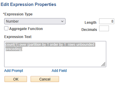

  • 7.  RE: Translating SQL to PS Query Manager
    Posted 09-25-2025 08:32 AM
    Anna,
    Would this meet the need?
    count(1) over (partition by 1 order by 1  rows unbounded preceding)
    Bob

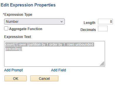

  • 8.  RE: Translating SQL to PS Query Manager
    Posted 09-25-2025 08:42 AM
    Anna,
    Would this work?
    Robert Fogarty PMP
