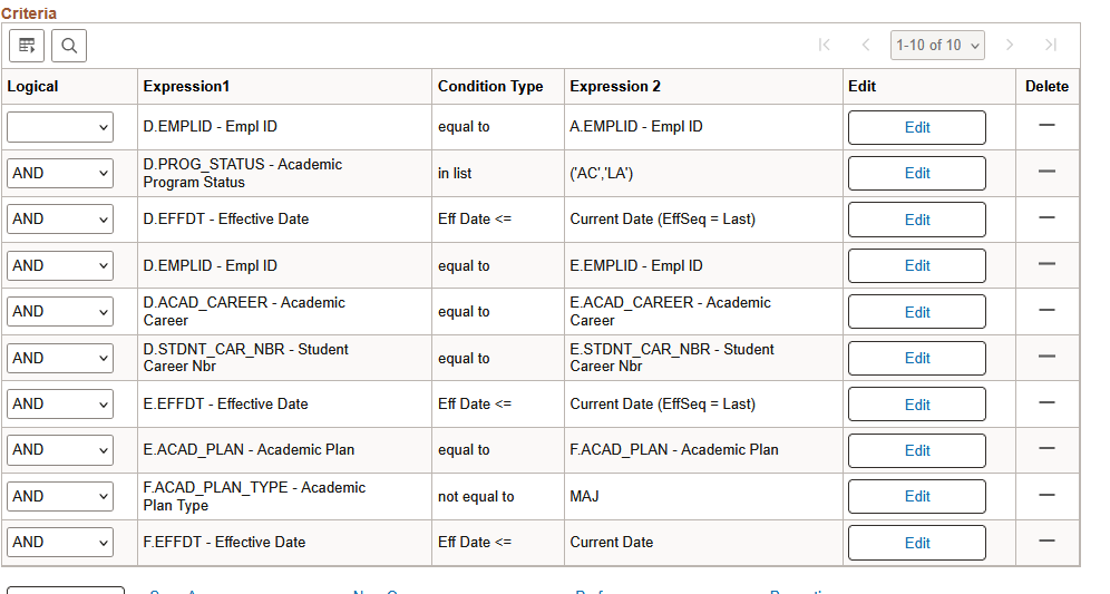

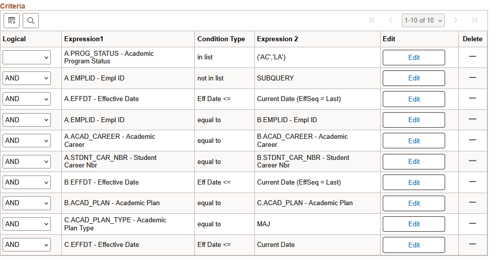

    We use Education Level on DEGREE_TBL to identify certificates. Sticking with your example: pull students with a plan type and exclude those who have another plan type. I would use a "not in list" subquery to exclude a list of EMPLID for those with another plan type. (you can also use does not exist subquery).
    The second screenshot is the subquery. Both are ACAD_PROG, ACAD_PLAN and ACAD_PLAN_TBL
