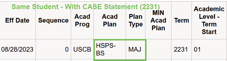

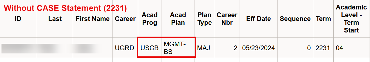

    Thanks for the helpful suggestions Daniel and Mark. Upon closer look at the query I did find that I did an incorrect join on the instructor view table and did not do a left join the academic standing table.  Since this query as an update to an older query written in 2018, I decided to leave the first set of record tables as is after finding the incorrect joins.
    Mark - I incorporated your suggestion regarding the CASE statement and this further enhanced the query as you noted in your reply. For instance, this is what I observed when validating a student. The query used to pull in the most recent program plan and with the CASE statement, it is now pulling in the program plan based on the most recent effective date for the specified term.
    Older Version Query-
    Revised Version of Query-
